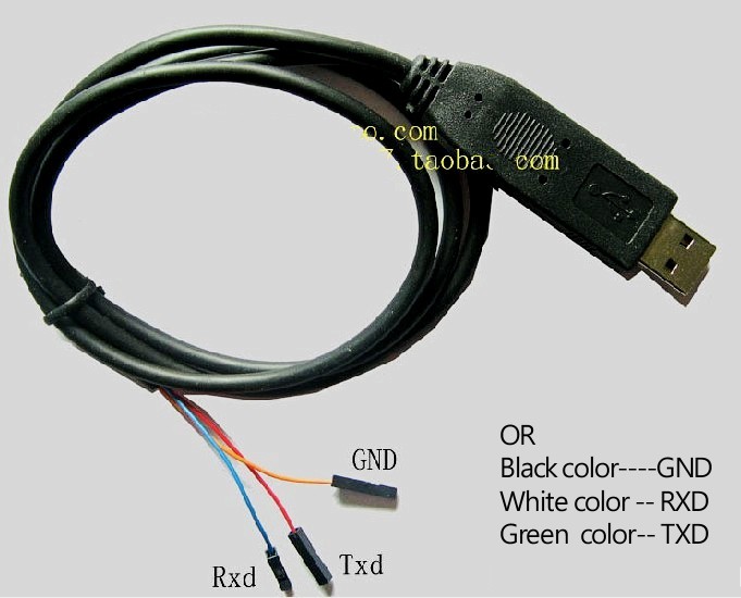

You will need to open your InnoTab and solder on the converter wires to the RX, TX and Ground points as seen in the picture. The ground is the one that is not labelled. Also get the drivers installed to your PC for the converter and plug it in to a USB slot.
